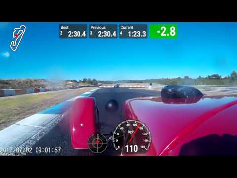

I have the Pro version I bought back in 2015. My phone is a OnePlus One currently running Android 6.0.1. I use a external camera SJ4000. I do a few track days per year and use these to make the videos with overlay.
Last July I did a track day and was able to copy the video from the cam's card to the phone, synch there and export the overlay. Then upload to youtube (i.e. ).
