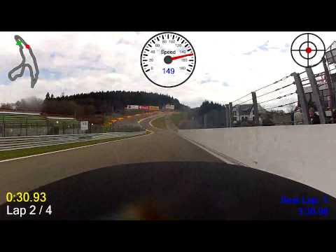

  • Thank's for the support guys. Had already gotten myself racerender but i am a bit disappointed.
    I started out whit an 1080p GoPro video and after rendering in racerender (using the mpeg codec at best quality)
    the video quality is degraded to something you would have found in the very first webcams.
    Anything obvious i am missing regarding video quality?

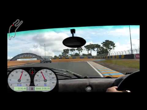

    Here's the video on youtube, its not due to youtube uploading cause it looks the same on my local PC
    thanks again for the help guys.
  • I'm not exactly an expert on RaceRender use, but I would imagine the MPEG is wrong choice for output codec. How about h.264 inside .mkv container?
  • the mpeg codec is h.264 as far as i could tell........
    Thank's for the suggestion though.
    edited May 2013
    Well there is MPEG-4 AVC which is more commonly called h.264, but there is also MPEG-1 and MPEG-2 which are definitely low end. Anyhow you probably will get better help on the video quality issues by contacting RaceRender support :)
  • Pretty sure it's not a RaceRender issue (unless it's a config setting) as I had really good results with it using a Kodak Zi8 (h.264 MPEG-4 .mov files), although the embedded YouTube player has done it no favours.

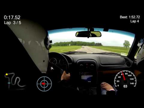

  • This is my video from a gopro 3 black ran through racerenderer
    For racerenderer my settings for 1080p 30fps were h264, 16:9, 1080p, 29.97fps, audio: 16bit 44100hz, picture scaling quality: maximum. Video bitrate 10240kbps, audio bitrate 192kbps. Make sure your bitrate is set right, that's what determines how much the video is compressed during rendering.
