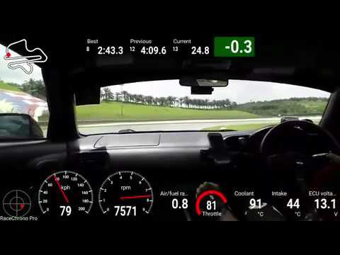

  • good news! i got it working. the only thing is the AFR. it read 0.8 to 2, would prefer to have it like 11.00 to 17.00. is there a way i can change the unit of measurement?
  • here is the video of Racechrono with Hondata Flashpro:
    edited April 2017
    Very good. The channel is actually "Fuel–Air commanded equivalence ratio".
    To get a gasoline engine AFR reading, following calculation needs to be done: "To obtain the actual air/fuel ratio being commanded, multiply the stoichiometric A/F ratio by the equivalence ratio. For example, gasoline, stoichiometric is 14.64:1 ratio. If the fuel control system was command an equivalence ratio of 0.95, the commanded A/F ratio to the engine would be 14.64 * 0.95 = 13.9 A/F"
    I assume the value 2.0 is "unknown".
    I will fix this soon, and add separate "Gasoline engine Air/Fuel ratio".
  • Thanks man! However, AFR apparently was up to one decimal point hence, unable to capture a more specific reading.
  • Yeah, that's no good, need to have one more decimal. The exact value from OBD-II is saved but just not displayed correctly in the gauge.
  • I shall wait for your fix and hope it can happen real soon. Thanks AOL
