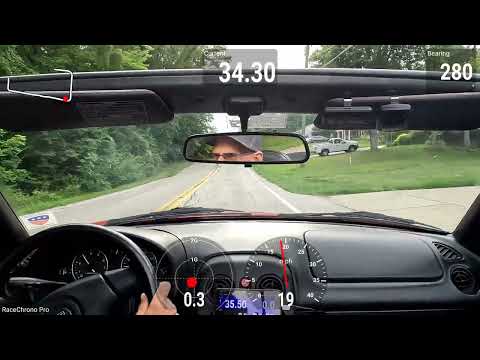

    After a good test and allowing RCP to download, connect and sync the video file, I found that the auto-sync was a solid two seconds off between the elapsed time on the overlay and the elapsed time that was visible on RCP in my car when viewing the video file, which tells me that the auto-sync from connecting the file in the session is very much off the mark. Is that just something I have to live with and manually adjust? I know your documentation said it might be off a little but, that that seems like a great deal. Here is the video file uploaded from RCP to Youtube straight from the app so you can see for yourself:
    Part of the reason I wanted to date/time overlay was to help with the manual sync problem. it is very hard to do given how small the video is on the RCP sync page - I try to use the elapsed time or speed readout on the RCP visible in the shot to match to the graph on the sync page to get an exact sync and since I can't zoom the video on that page I was hoping that the auto-sync might be more accurate than that?

    Current way of doing auto sync is never perfect, as it just matches the GPS time embedded to the video - not the actual audio and video, so you'll need to fine tune it manually. But it is a lot simpler than syncing the video from scratch, as the automatic sync is usually within second or two.
    There automatic sync points with GoPro remote control feature have the same exact problem, so there's no way to avoid the fine tuning.
    Upcoming v8.0.4 will allow selecting "Time" for a digital gauge, to display the GPS timestamp. But notice that displaying GoPro timestamp on the video and matching it with RaceChrono timestamp will not help you much. The "automatic sync" does exactly that already.
    Doing a perfect automatic sync would need completely different approach, such as audio cues.
