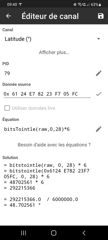

I finally found how to get the GPS data on the CANBus of the car PID 0x4F or 79
To calculate the latitude for example I apply the formula :
bitsTointle(raw,0,28)*6
I multiply by 6, because the display in degree divided by 6000000 which is not intuitive
https://i.postimg.cc/dVkNmF7S/Screenshot-20220719-094053-Race-Chrono-Pro.jpg

Strangely there is a factor of 60 between the real and the recorded values
2606/60=43.43° 😊
It's better if it's corrected.
That's okay, I'll correct my equations.
