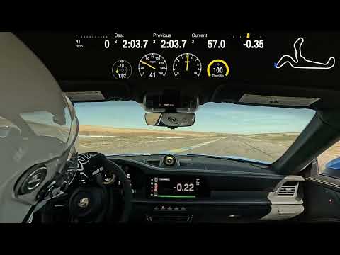

this a sample i recorded late last year (i unfortunately messed up the external mic), but this is iPhone, GoPro (with DJI Mic), Racebox Mini, Kiwi3 ODB
the only issue is ODB is slow, after adding 2 or 3 channels, only expect about 2-4hz for data updates. Racebox will be at 25hz no problem tho.
